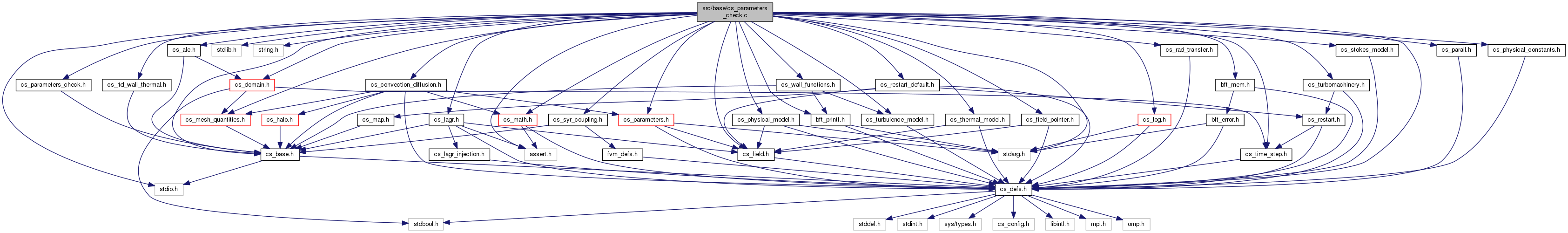

#include "cs_defs.h"#include <assert.h>#include <stdarg.h>#include <stdio.h>#include <stdlib.h>#include <string.h>#include "bft_mem.h"#include "bft_printf.h"#include "cs_1d_wall_thermal.h"#include "cs_ale.h"#include "cs_base.h"#include "cs_domain.h"#include "cs_field.h"#include "cs_field_pointer.h"#include "cs_lagr.h"#include "cs_log.h"#include "cs_math.h"#include "cs_mesh_quantities.h"#include "cs_parameters.h"#include "cs_parall.h"#include "cs_physical_constants.h"#include "cs_physical_model.h"#include "cs_rad_transfer.h"#include "cs_restart_default.h"#include "cs_thermal_model.h"#include "cs_time_step.h"#include "cs_turbomachinery.h"#include "cs_turbulence_model.h"#include "cs_stokes_model.h"#include "cs_syr_coupling.h"#include "cs_wall_functions.h"#include "cs_convection_diffusion.h"#include "cs_parameters_check.h"
