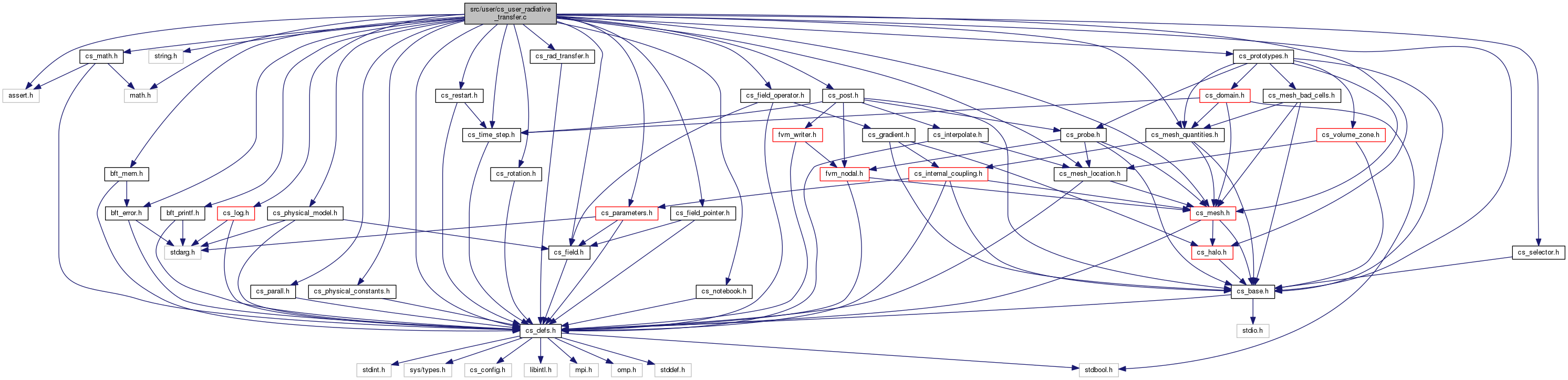

#include "cs_defs.h"#include <assert.h>#include <string.h>#include <math.h>#include "bft_mem.h"#include "bft_error.h"#include "bft_printf.h"#include "cs_base.h"#include "cs_field.h"#include "cs_field_pointer.h"#include "cs_field_operator.h"#include "cs_math.h"#include "cs_mesh.h"#include "cs_mesh_location.h"#include "cs_mesh_quantities.h"#include "cs_halo.h"#include "cs_log.h"#include "cs_notebook.h"#include "cs_parall.h"#include "cs_parameters.h"#include "cs_physical_constants.h"#include "cs_physical_model.h"#include "cs_prototypes.h"#include "cs_restart.h"#include "cs_rotation.h"#include "cs_time_step.h"#include "cs_selector.h"#include "cs_rad_transfer.h"#include "cs_post.h"
