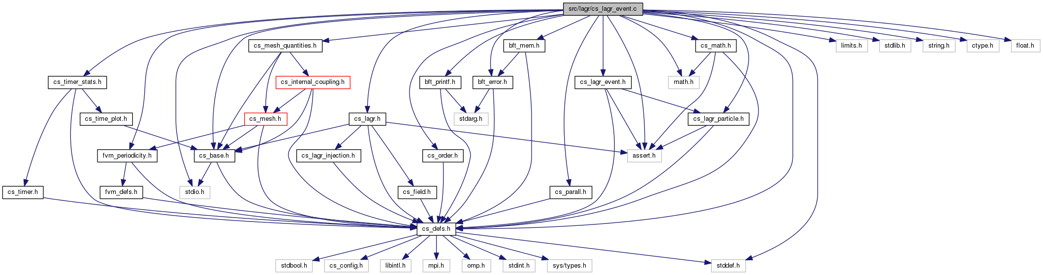

Include dependency graph for cs_lagr_event.c:
