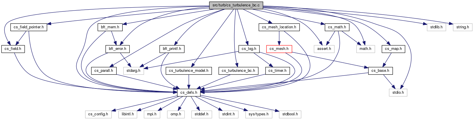

cs_turbulence_bc.c File Reference
#include "cs_field_pointer.h"
#include "cs_map.h"
#include "cs_math.h"
#include "cs_mesh_location.h"
#include "cs_turbulence_bc.h"
Include dependency graph for cs_turbulence_bc.c:
