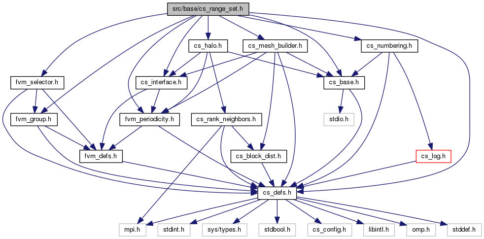

#include "cs_defs.h"#include "fvm_group.h"#include "fvm_selector.h"#include "fvm_periodicity.h"#include "cs_base.h"#include "cs_halo.h"#include "cs_interface.h"#include "cs_numbering.h"#include "cs_mesh_builder.h"
