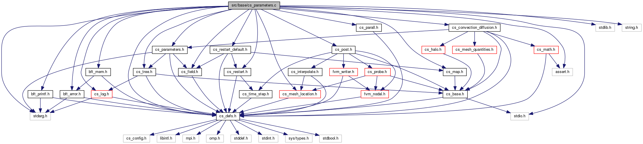

Include dependency graph for cs_parameters.c:
