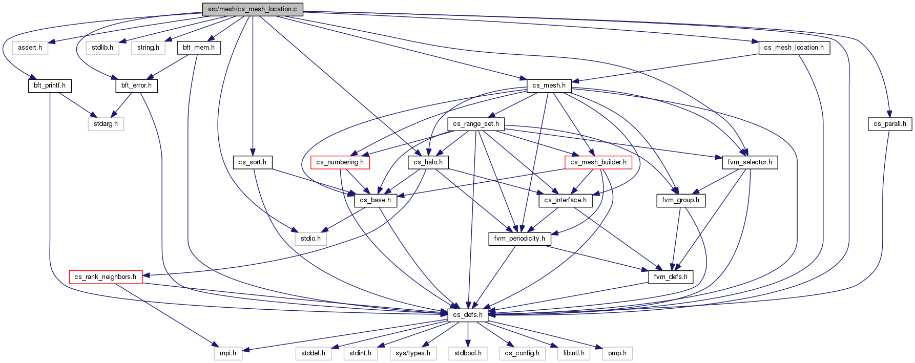

Include dependency graph for cs_mesh_location.c:
