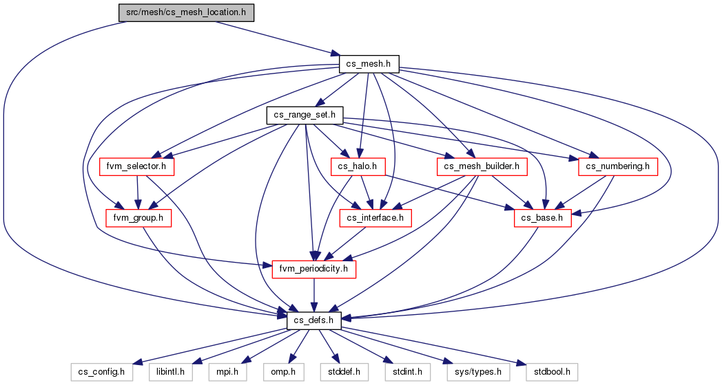

Include dependency graph for cs_mesh_location.h:
