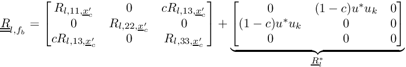

$ \tens{R}_{g,\fib} $ should be computed as a function of $\tens{R}_{g,\centip}$ as follows:
\[ \tens{R}_{g,\fib}=\tens{P}_{lg}\tens{R}_{l,\fib}\transpose{\tens{P}_{lg}} \]
with
\[ \tens{R}_{l,\fib} = \begin{bmatrix} R_{l,11,\centip} & 0 & c R_{l,13,\centip}\\ 0 & R_{l,22,\centip} & 0 \\ c R_{l,13,\centip} & 0 & R_{l,33,\centip} \end{bmatrix} + \underbrace{\begin{bmatrix} 0 & (1-c) u^* u_k & 0 \\ (1-c) u^* u_k & 0 & 0 \\ 0 & 0 & 0 \end{bmatrix}}_{\vect{R}_l^*} \]
and $\tens{R}_{l,\centip}=\transpose{\tens{P}_{lg}}\tens{R}_{g,\centip} \tens{P}_{lg}$.
Constant c is chosen depending on the type of the boundary face: $c = 0$ at a wall face, $c = 1$ at a symmetry face.
