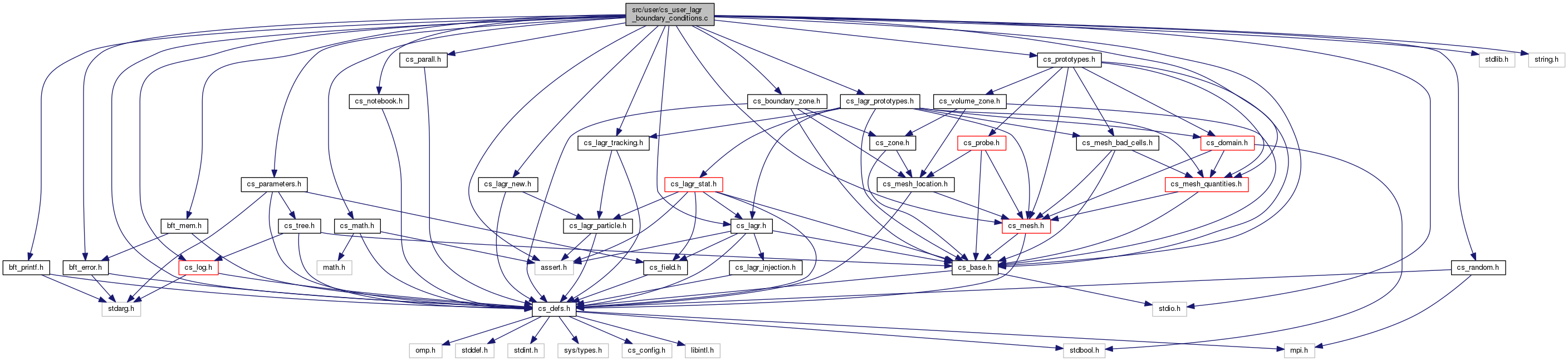

#include "cs_defs.h"#include <stdio.h>#include <stdlib.h>#include <string.h>#include <assert.h>#include "bft_mem.h"#include "bft_error.h"#include "bft_printf.h"#include "cs_base.h"#include "cs_boundary_zone.h"#include "cs_math.h"#include "cs_notebook.h"#include "cs_parall.h"#include "cs_parameters.h"#include "cs_prototypes.h"#include "cs_random.h"#include "cs_mesh.h"#include "cs_mesh_quantities.h"#include "cs_log.h"#include "cs_lagr.h"#include "cs_lagr_new.h"#include "cs_lagr_tracking.h"#include "cs_lagr_prototypes.h"
