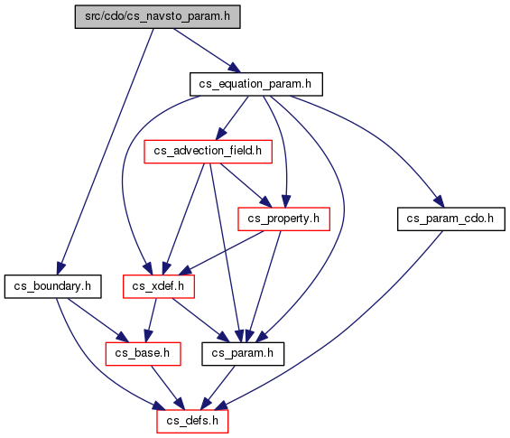

#include "cs_boundary.h"
#include "cs_equation_param.h"
Include dependency graph for cs_navsto_param.h:
