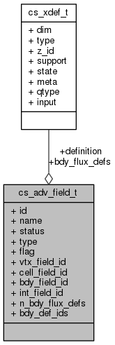

Collaboration diagram for cs_adv_field_t:
Collaboration graph
