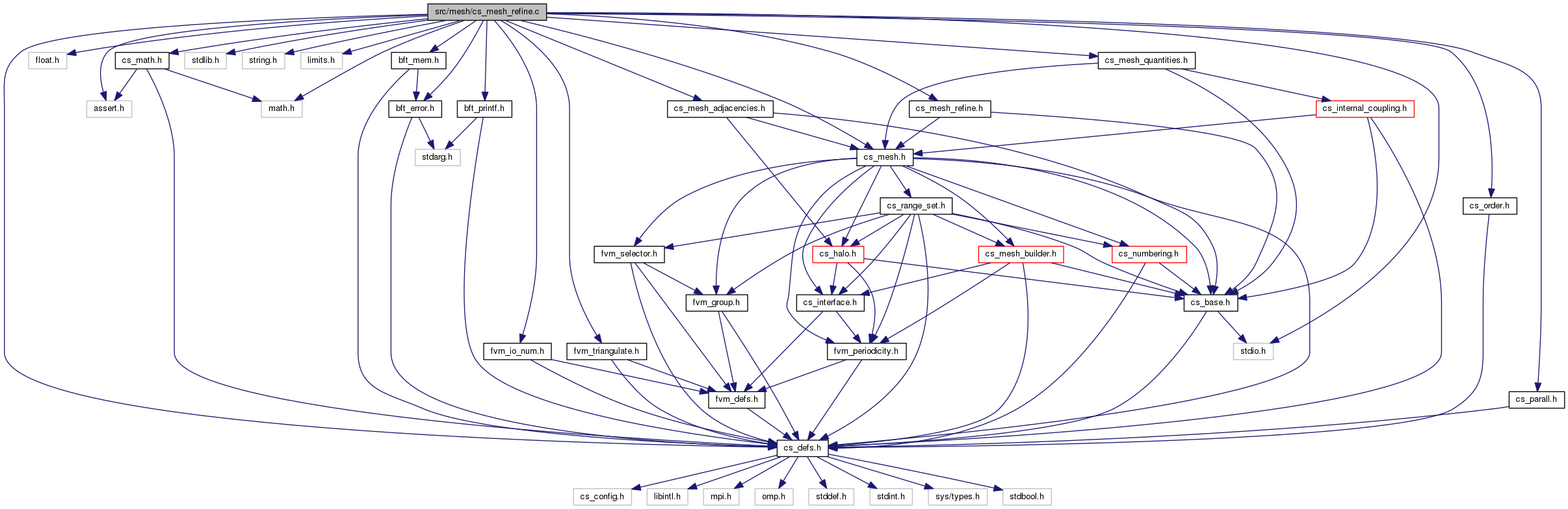

cs_mesh_refine.c File Reference
#include <limits.h>
#include "fvm_io_num.h"
#include "fvm_triangulate.h"
#include "cs_math.h"
#include "cs_order.h"
#include "cs_mesh_refine.h"
Include dependency graph for cs_mesh_refine.c:

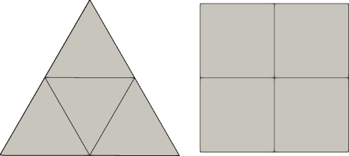

Basic face refinement templates

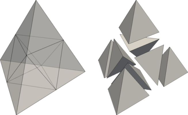

Basic tetrahedron refinement template and subcells

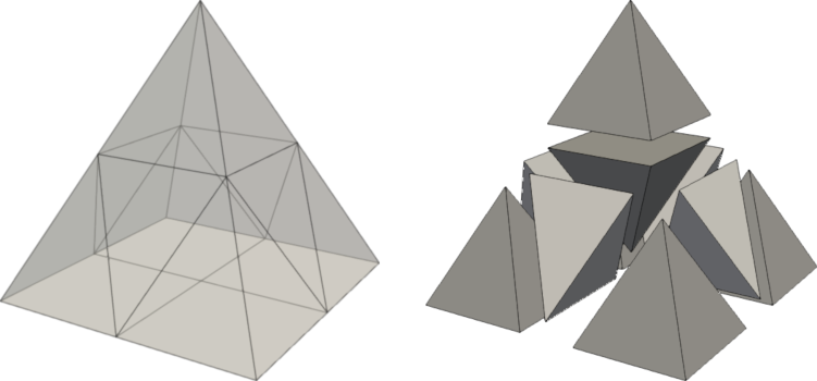

Basic pyramid refinement template and subcells

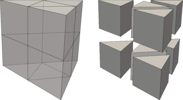

Basic prism refinement template and subcells

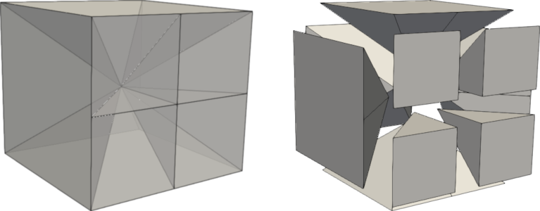

Polyhedron refinement and subcells example
