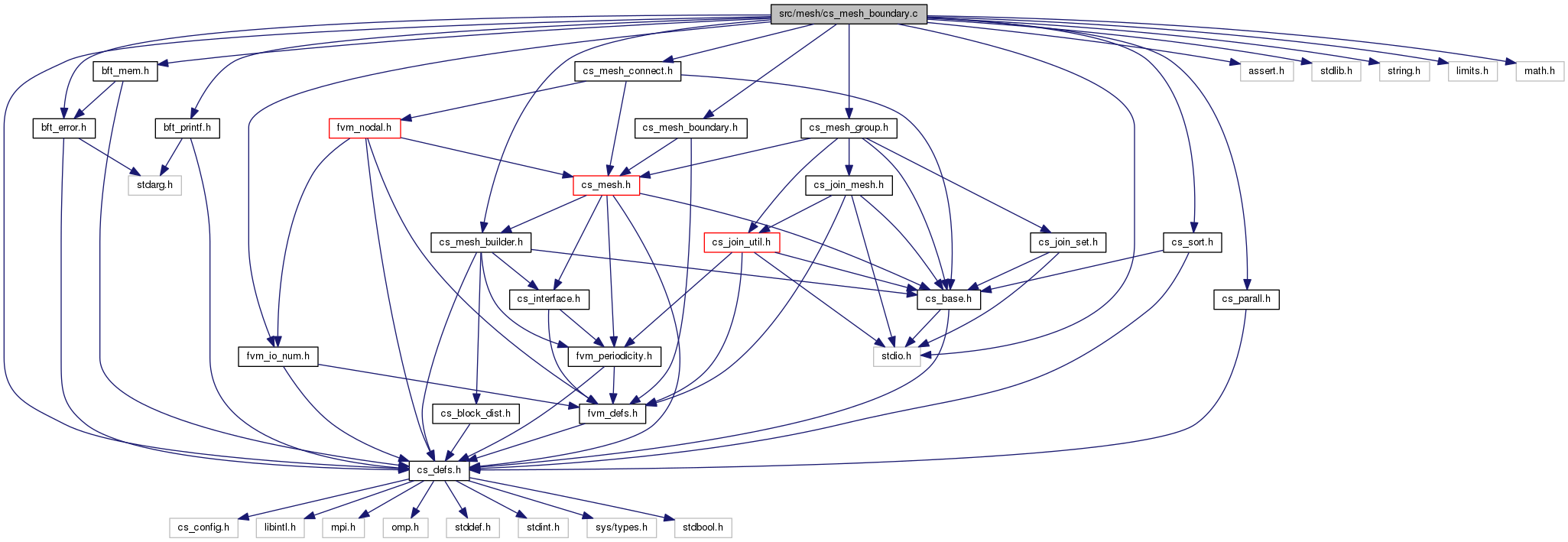

cs_mesh_boundary.c File Reference
#include <limits.h>
#include "fvm_io_num.h"
#include "cs_mesh_builder.h"
#include "cs_mesh_connect.h"
#include "cs_mesh_group.h"
#include "cs_sort.h"
#include "cs_mesh_boundary.h"
Include dependency graph for cs_mesh_boundary.c:
