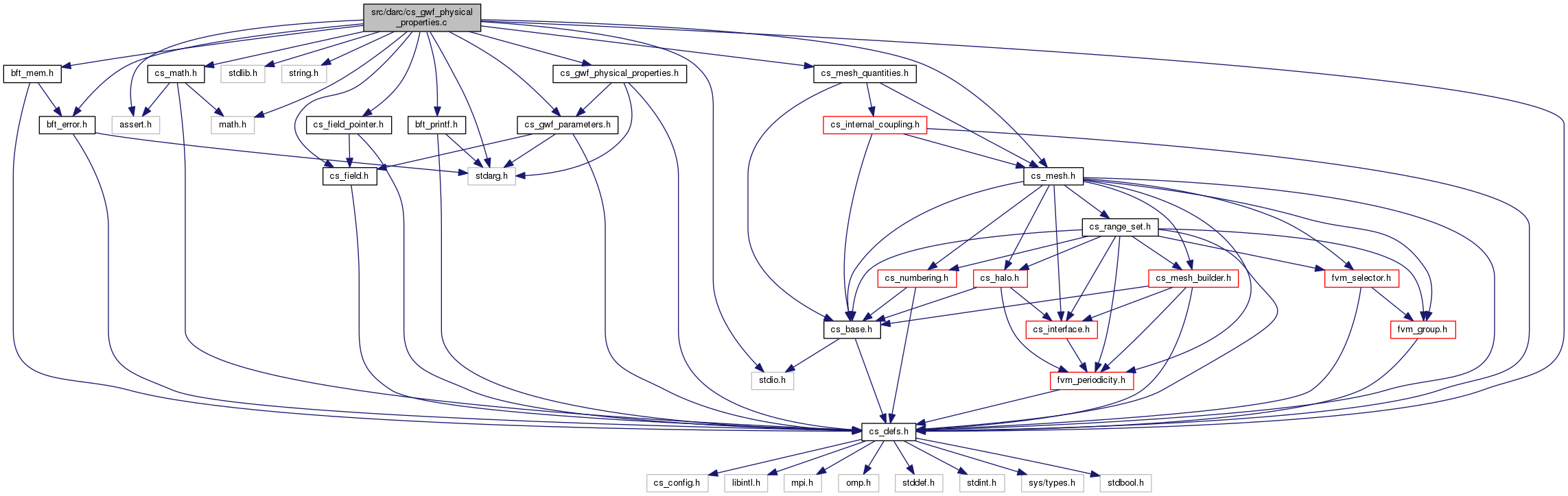

Include dependency graph for cs_gwf_physical_properties.c:
