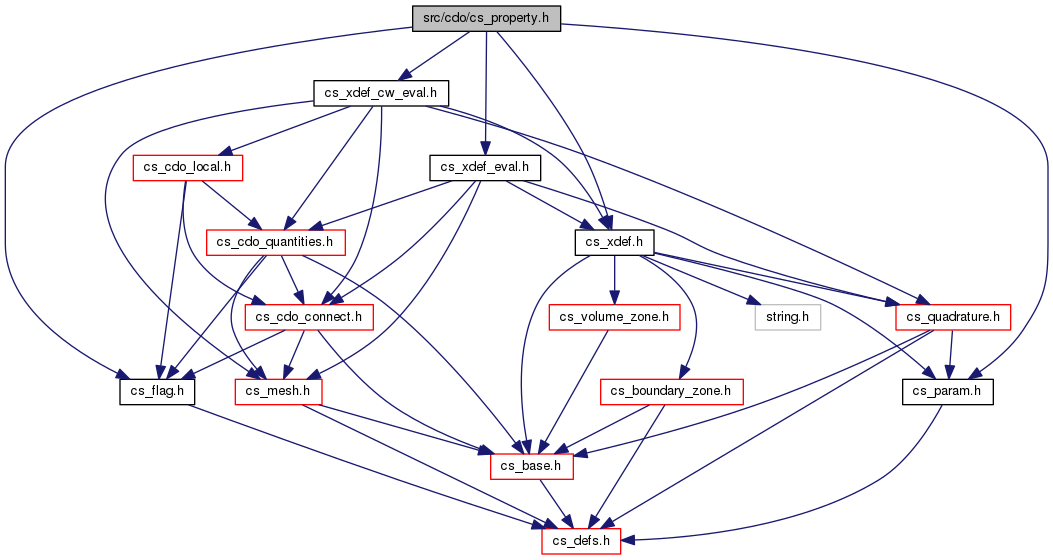

cs_property.h File Reference
#include "cs_flag.h"
#include "cs_param.h"
#include "cs_xdef.h"
#include "cs_xdef_cw_eval.h"
#include "cs_xdef_eval.h"
Include dependency graph for cs_property.h:
