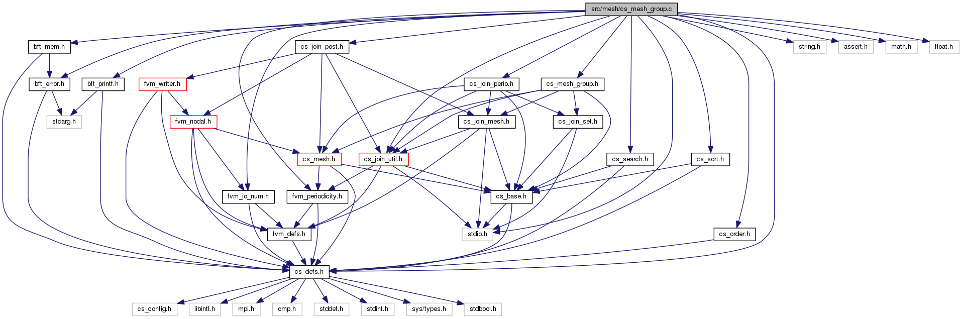

#include "cs_defs.h"#include <stdio.h>#include <string.h>#include <assert.h>#include <math.h>#include <float.h>#include "bft_mem.h"#include "bft_error.h"#include "bft_printf.h"#include "fvm_io_num.h"#include "fvm_periodicity.h"#include "cs_order.h"#include "cs_search.h"#include "cs_sort.h"#include "cs_join_perio.h"#include "cs_join_post.h"#include "cs_join_util.h"#include "cs_mesh_group.h"
