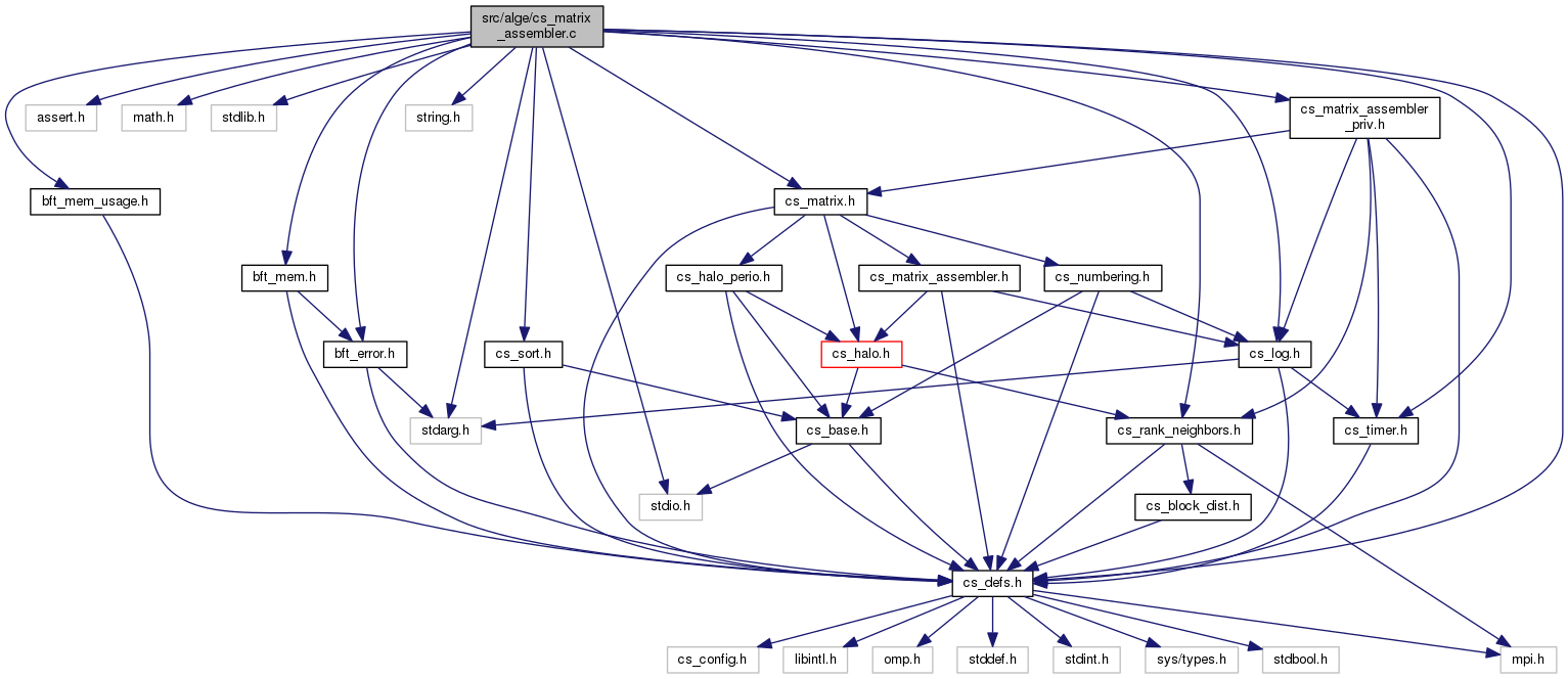

#include "cs_defs.h"#include <assert.h>#include <math.h>#include <stdlib.h>#include <stdarg.h>#include <stdio.h>#include <string.h>#include "bft_error.h"#include "bft_mem.h"#include "bft_mem_usage.h"#include "cs_log.h"#include "cs_rank_neighbors.h"#include "cs_sort.h"#include "cs_timer.h"#include "cs_matrix.h"#include "cs_matrix_assembler_priv.h"
