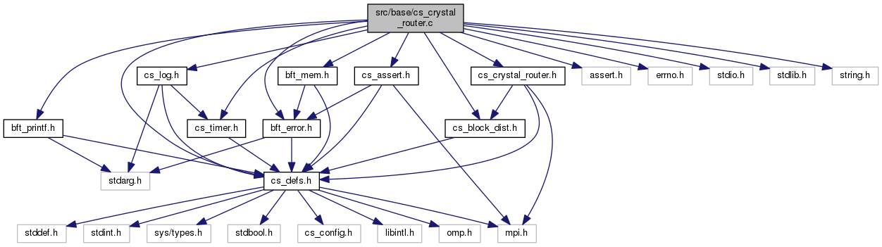

#include "cs_defs.h"#include <assert.h>#include <errno.h>#include <stdio.h>#include <stdlib.h>#include <string.h>#include "bft_mem.h"#include "bft_error.h"#include "bft_printf.h"#include "cs_assert.h"#include "cs_block_dist.h"#include "cs_log.h"#include "cs_timer.h"#include "cs_crystal_router.h"
