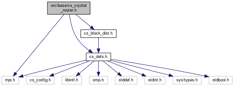

Include dependency graph for cs_crystal_router.h:
