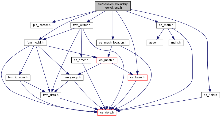

cs_boundary_conditions.h File Reference
#include <ple_locator.h>
#include "fvm_nodal.h"
#include "fvm_writer.h"
#include "cs_math.h"
#include "cs_mesh_location.h"
Include dependency graph for cs_boundary_conditions.h:
