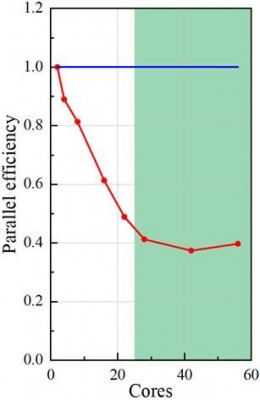

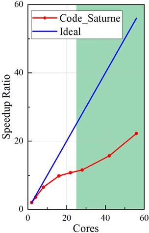

I tested the parallel performance on the cluster, using 2~56 cores. Could you suggest me, based on your experience, whether this parallel performance is good or not?
Please see the two graphs below. The speedup ratio is calculated by (time using 1 core)/(time using n cores). The parallel efficiency is calculated by (speedup ratio)/(core number). I got a parallel efficiency of about 40%. I followed the suggestion: putting 20000~80000 cells per core. This suggested region is highlighted in green.
I can see you are very experienced in parallel optimization, with many papers published. I really appreciate your help.
Ruonan
Thank you! I still have no idea what to do with the previous error. But I tried other nodes with different features. Then all the errors disappeared. I think some nodes on my cluster are not compatible with Saturne, or need special settings maybe, for some reason.
Ruonan

What type of cluster do you have (processor type, network type, ... and even MPI library install)? From one of your older logs I would say Intel(R) Xeon(R) Gold 5120, but that does not tell me whether you have a fast network (Infiniband for example or something with higher latency (Gigabit Ethernet maybe). Or whether the MPI drivers make the best of the network (the compilers and system seem old).
Even on our own clusters (the latest is the one described here https://top500.org/system/179899/), we can observe a factor of 2 on the performance depending on the compilers and especially MPI library configuration used (between optimized libraries and a "generic" workstation-type configuration).
Partitioning quality may play a major role, as well as load balance. Do you have the performance.log files for some of your runs on different number of processes ?
Also, are other codes running on the same nodes, or do you have exclusive access (such as when using SLURM's --exclusive option, or whatever equivalent option LSF, Torque, or the scheduler/resource manager you use may have ?
And finally, some specific models might not scale as well as the commonly-used ones. The info in timer_stats.csv and performance.log can provide precious feedback, to help see where things are slower.
All these factors can be important.

Thanks a lot for your very useful comments. I have attached the performance.log files when using 2cores, 28cores and 56 cores. I really appreciate it if you could help check.
Here are some details of my cluster:
Processor type: Intel(R) Xeon(R) CPU E5-2660 v4 @ 2.00GHz
Network type: op
MPI version: 3.0 (MPICH 3.1.2)
I have "gold-5120" nodes as well, but these nodes give me errors described in the previous post. So I can only use "e5-2660" nodes now.
Yes, I use "--exclusive" command.
Ruonan
Network type: op
Ruonan
