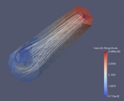

Hi,
Following these steps
http://code-saturne.org/forum/viewtopic.php?f=2&t=1792
I have added a spherical obstacle and traced the streams.
Now I would like to compute the forces torsor of the fluid pressure onto the spherical surface.
Is there a way to do that ?
Best regards
Gregory
