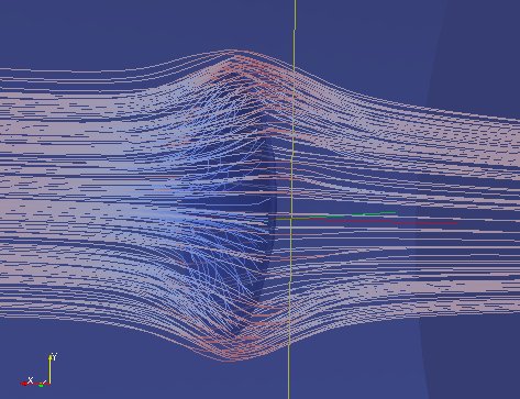

I have used cs_user_extra_operations-global_efforts.f90 to compute the front and back efforts on this object.
Radius=600
Fluid velocity : 22m/s Density 1kg/m3 Viscosity 2e-5 Pa.s
And would like to compare to a drag formula F = 0.5 x Density x Coef x Surface x (Velocity)²
With a coef between 1.2 and 1.4 for that kind of shape
cs_user_extra_operations-global_efforts.f90 gives for front face:
-325033805.78958094
5992733.2299289312
2860901.3372025760
for backface:
-816116463.33382785
8027348.1732968809
23022411.520196483
(In Salome I used radius 600 assuming millimeters. As Saturne assumes meters my efforts are 1e6 higher.)
The frontface efforts seem to correspond to the formula with a coef 1.2
But the backface efforts are more than twice !
I think I should add the front and back efforts to compute the total drag. But the result is more than x3 the formula!
Am I wrong ?
The velocity is -x direction and the shape perpendicular so there is also unexpected lateral efforts ...
Regards
Gregory
