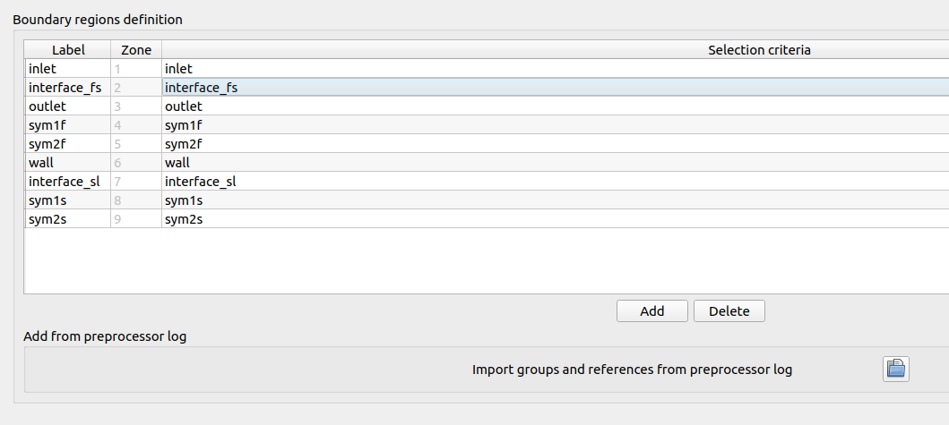

I try to have 2 meshes and join them.
The result is the same. I think that I don't know how to declare the interface again.
In the joining sub-menu I choose the 2 BC defined in Salome named "interface_fs" and "interface_sf" respectively the fluid/solid interface (boundary of the fluid volume) and the solid/fluid interface (boundary of the solid volume).
CS doesn't recognize these boundaries "interface_fs" and "interface_sf", I think that the joining operation failed.
The coupling is the solver.log = 0
The standard computation fails at the same stage than the cases before.
See the solver.log.file
Best regards

jgd23
Posts: 141
Joined: Mon Jun 06, 2016 10:00 am
Re: Conjugate heat transfert - 2D - Flow past cylinder
Post by jgd23 »
With the syntax 'interface_fs' OR 'interface_sf' or without the punctuation interface_fs OR interface_sf
gives exactly the same result.
Maybe my boundary declaration is not appropriate, I have 2 boundaries for the interface solid/ fluid?
Maybe someone has already define a simple case of CHT with CS where I can check everything compare to my case?
Best regards

Posts: 4303
Yes, the issue in you log is here:
Code_Saturne: /home/julien/Code_Saturne/code_saturne-7.2.0/src/base/cs_selector.c:111: Warning
The group "interface_sf" in the selection criteria:
"'interface_fs','interface_sf'"
does not correspond to any boundary face.
Global number of boundary faces selected for joining: 63
Because the selection criteria syntax seems wrong or not working.
Actually, I need to check if the "," alternative to "or" in selection criteria really works (it seems it may not; it should in theory, but most of the time, "or" is used instead, so it is not tested much).
Can you try using:
"interface_fs or interface_sl"
As a selection criteria (no quotes needed if done in the GUI).
jgd23
Posts: 141
Post by jgd23 »
With the join definition syntax:
the join is done but a new problem appears.
Again with some interface definition, see the solver log file
Best regards
