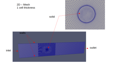

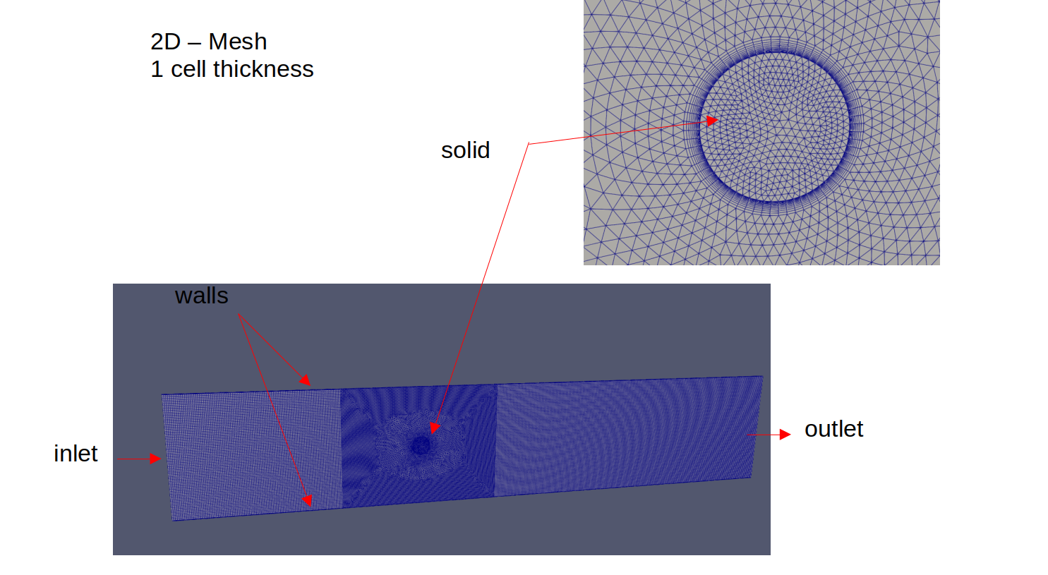

In order to find the right parameters for a 3D case, first I debug a more simple and well know 2D case "Flow past a cylinder".
I use Code Saturne internal coupling for the conjugate heat transfert.
My problem is that the simulation doesn't converge, the pressure diverges. See the error message log.
The Mesh is 100% ok. MED file done with Salome. The see log file
I switch for laminar with very low velocity, transient or steady, each time the same error occurs.
Could you advise me what is the issue with this case?

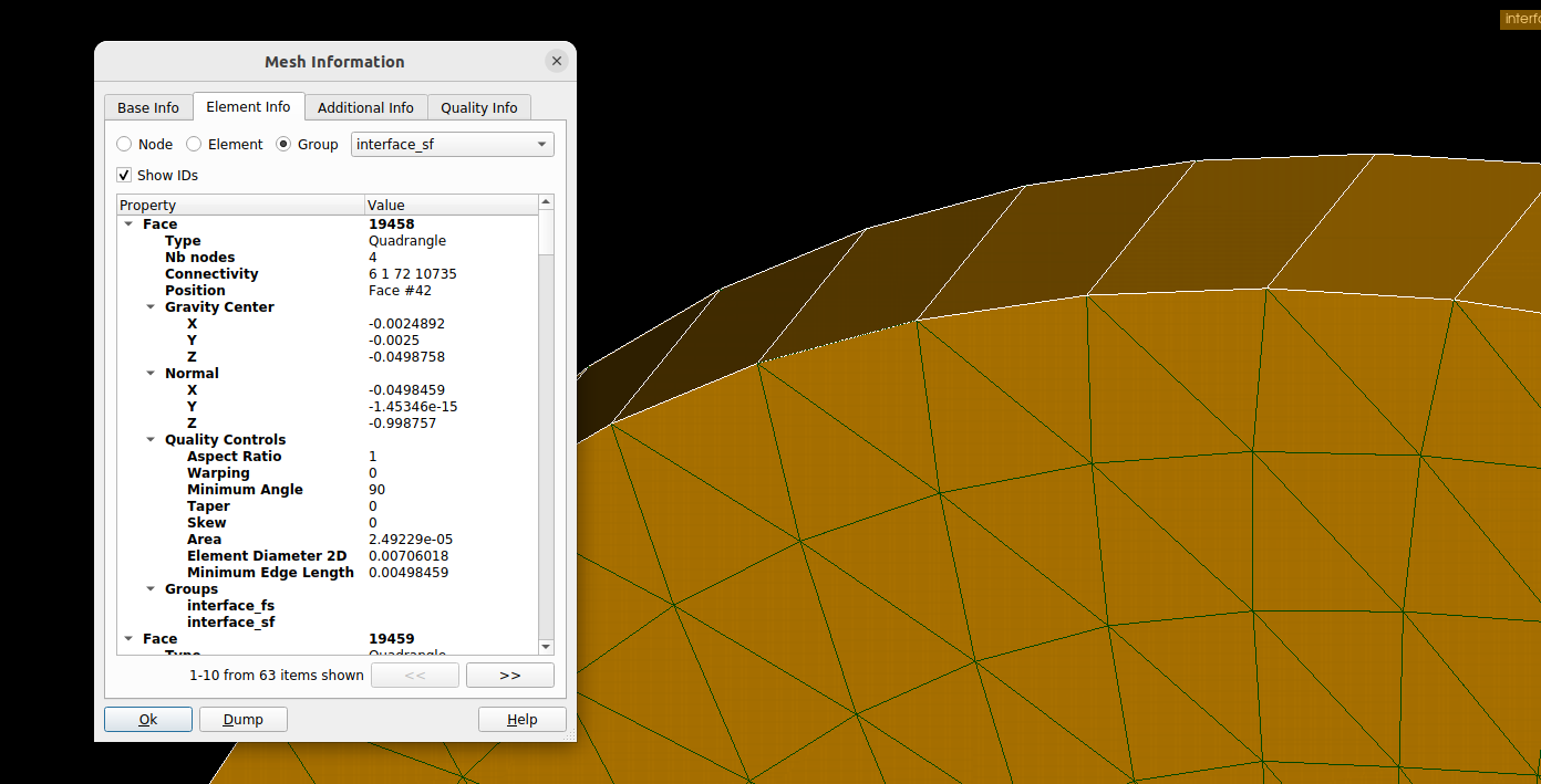

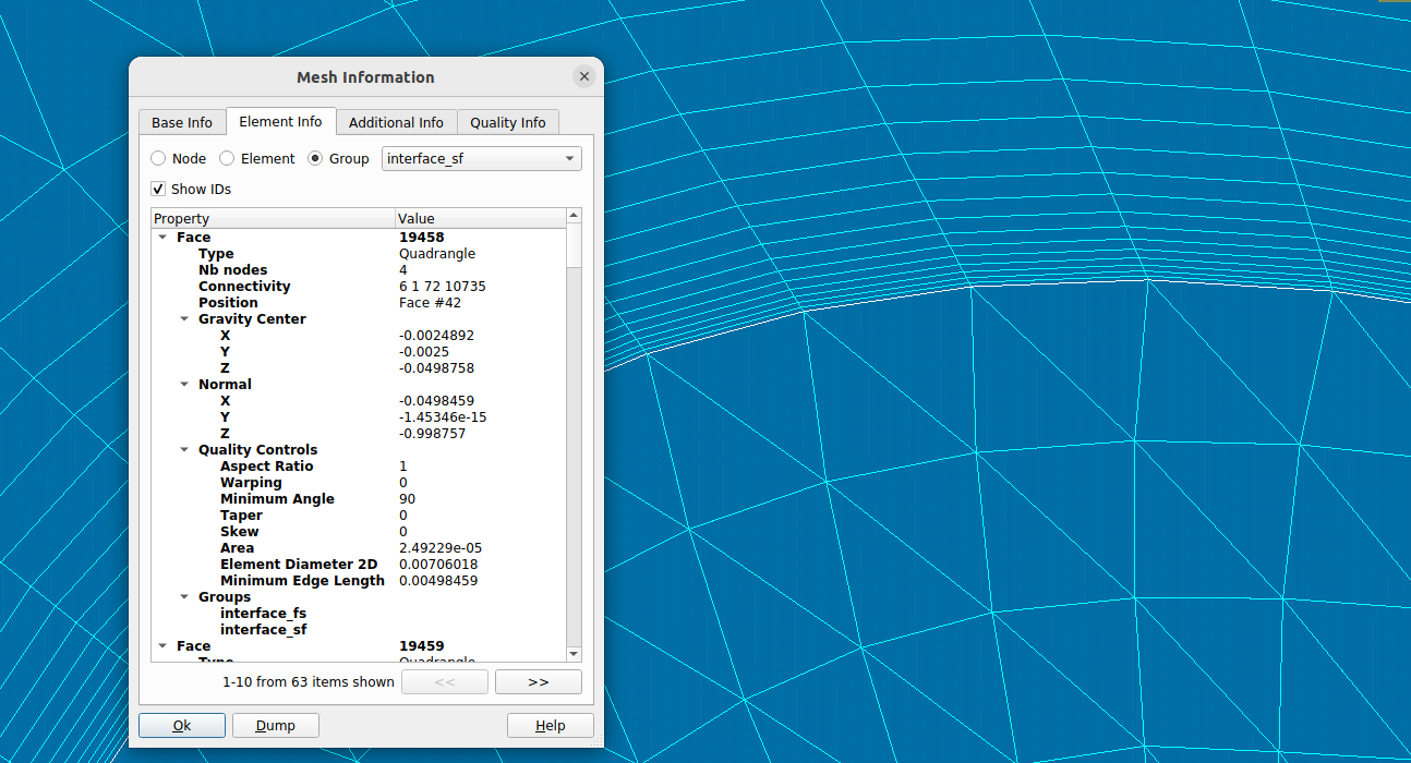

I have seen before post that the face 42 was not recognize but I don't pay attention to this because in my 3D case it was the same. I was thinking that the coupling between fluid-solid works anyway.
I triple check the name of the interface on Salome + paraview and I see that it is correct face 42 is the name of the interface.
This face is shared with the solid and fluid volumes. There is only one face.

My problem comes from the coupling definition in CS. The interface fluid/ solid is internal and after exporting the mesh in MED format I loose the group name of the interface. When I add manually the internal boundary in CS it is not recognized as shows the log files of the previous mail.

If you do not merge mesh nodes under SALOME, (keeping the interface as a boundary), you might be able to keep the boundary groups in the MED file. In this case, apply joining with that group's name as a selector in code_saturne to finish the joining.
An alternative (if the joining surface shape is simple) is to select the fluid/solid interface using geometric criteria (see -https://www.code-saturne.org/documentat ... ect_c.html). If this is sufficient, it is OK if you do not have a group name.
