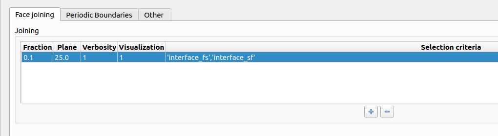

I try to have 2 meshes and join them.
The result is the same. I think that I don't know how to declare the interface again.
In the joining sub-menu I choose the 2 BC defined in Salome named "interface_fs" and "interface_sf" respectively the fluid/solid interface (boundary of the fluid volume) and the solid/fluid interface (boundary of the solid volume).
CS doesn't recognize these boundaries "interface_fs" and "interface_sf", I think that the joining operation failed.
The coupling is the solver.log = 0
The standard computation fails at the same stage than the cases before.

Maybe I'm wrong but I think it's suspecious that Saturne complains on interface named selections. I used fluid-fluid coupling with non-conformal meshes and calculation was OK. Here is my joining log:
As you can see, selection criteria in log is "IFC_CELL_AIR_FRONT_1 OR IFC_AIR_CELL_FRONT_1", in Saturne GUI it's without any quotes. In your log, there are extra-quotes and "," instead of OR. Maybe try with joining criteria interface_fs OR interface_sf ? Although, according to log, 63 faces are selected for joining. Maybe the problem related particulary to internal coupling...

Re: Conjugate heat transfert - 2D - Flow past cylinder
With the syntax 'interface_fs' OR 'interface_sf' or without the punctuation interface_fs OR interface_sf
gives exactly the same result.
Maybe my boundary declaration is not appropriate, I have 2 boundaries for the interface solid/ fluid?
Maybe someone has already define a simple case of CHT with CS where I can check everything compare to my case?
Thanks for your response. I have 2 BCs also, it's not an internal boundary and it's not a conformal mesh. The difference is that there is a fluid/fluid interface in my case. Will wait what Ivan says...
Yes, the issue in you log is here:
Code_Saturne: /home/julien/Code_Saturne/code_saturne-7.2.0/src/base/cs_selector.c:111: Warning
The group "interface_sf" in the selection criteria:
"'interface_fs','interface_sf'"
does not correspond to any boundary face.
Global number of boundary faces selected for joining: 63
Because the selection criteria syntax seems wrong or not working.
Actually, I need to check if the "," alternative to "or" in selection criteria really works (it seems it may not; it should in theory, but most of the time, "or" is used instead, so it is not tested much).
Can you try using:
"interface_fs or interface_sl"
As a selection criteria (no quotes needed if done in the GUI).
With the join definition syntax:
the join is done but a new problem appears.
Again with some interface definition, see the solver log file
