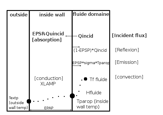

Radiative transfer boundary conditions
Sketch of thermal flux in boundary walls
The radiative boundary condition is based on the calculation of a new wall temperature. This temperature is computed with a thermal flux balance:
Therefore :
- Note
- In
code_saturne the flux is positive when it is oriented from inside to outside.
