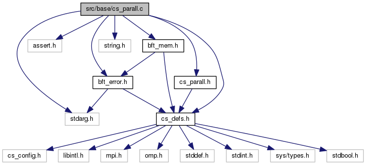

Include dependency graph for cs_parall.c:
