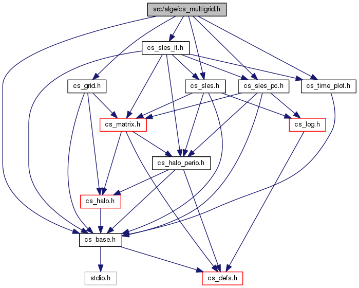

Include dependency graph for cs_multigrid.h:
