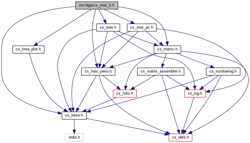

#include "cs_base.h"#include "cs_halo_perio.h"#include "cs_matrix.h"#include "cs_time_plot.h"#include "cs_sles.h"#include "cs_sles_pc.h"
