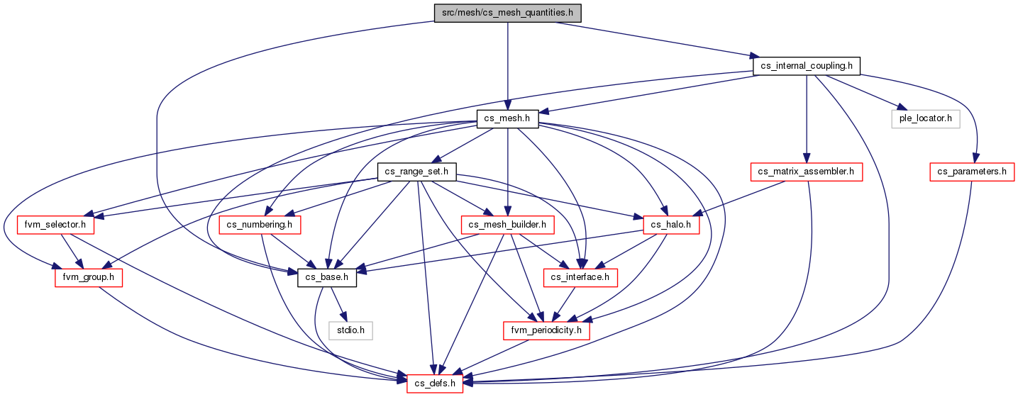

cs_mesh_quantities.h File Reference
#include "cs_internal_coupling.h"
Include dependency graph for cs_mesh_quantities.h:
