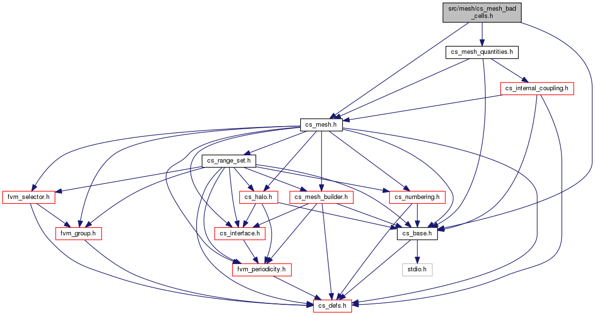

Include dependency graph for cs_mesh_bad_cells.h:
