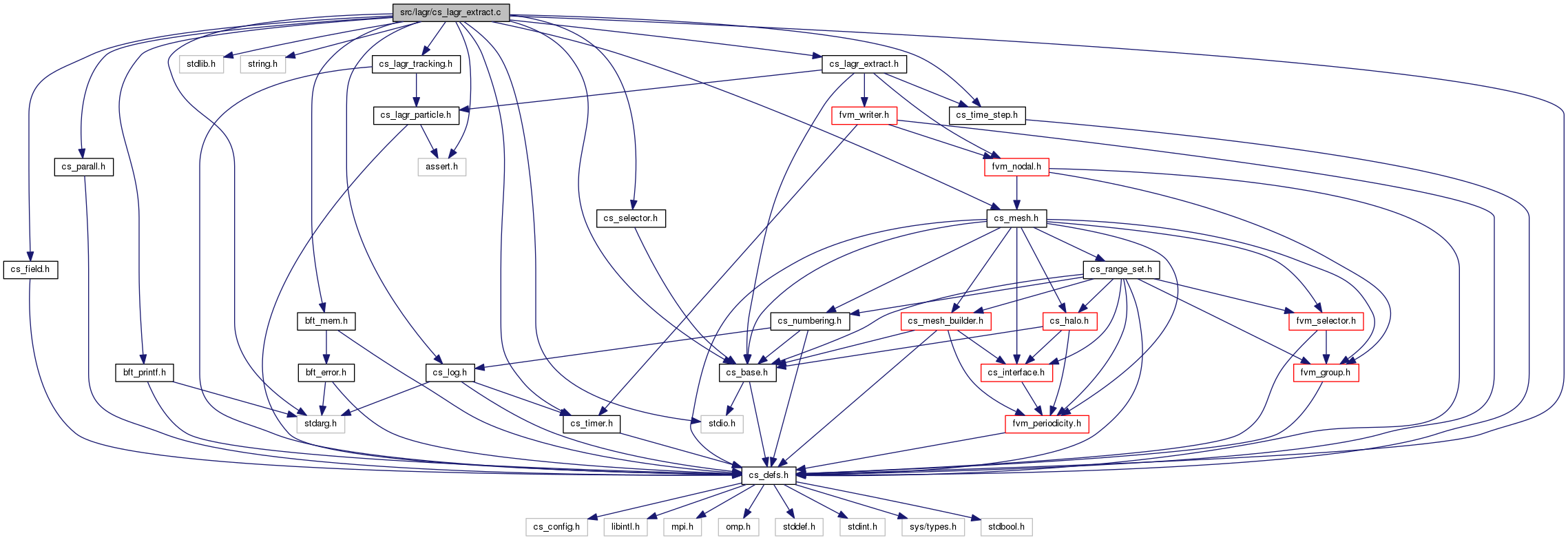

Include dependency graph for cs_lagr_extract.c:
