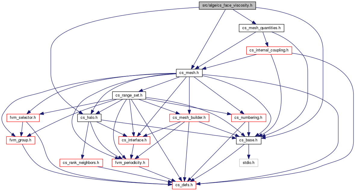

Include dependency graph for cs_face_viscosity.h:
