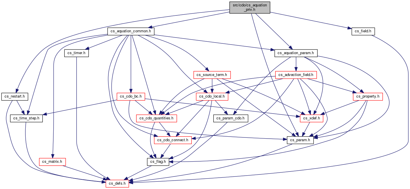

cs_equation_priv.h File Reference
#include "cs_equation_param.h"
#include "cs_equation_common.h"
#include "cs_param.h"
#include "cs_restart.h"
Include dependency graph for cs_equation_priv.h:
