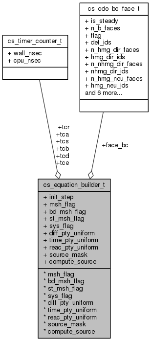

Collaboration diagram for cs_equation_builder_t:
Collaboration graph
