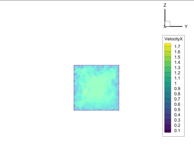

There are ductline ,outlet,inlet velocity profile after implementing the mapped inlet boundary conditions. Additionally, I would Not using the mapped inlet implies the need to set the inlet and outlet as periodic boundaries in the GUI, and subsequently use source terms to counterbalance shear forces?

Thanks for your suggestions on streamwise periodicity. I've implemented the "cs_user_source_terms.c" file you shared to maintain a continuous balance between the source term and friction. My question is that how can we determine the appropriate value for the momentum in the statement 'cs_real_t momentum = 1;'?
I've experimented with different values, including those from the example provided in the Code_Saturne GUI:
#example:
tau = 10.; # relaxation time (s)
vel_x_imp = 1.5; #target velocity (m/s)
Su = rho * (vel_x_imp - u) / tau;
dSudu = - rho / tau; # Jacobian of the source term
These values result in the spatial mean velocity in the 'run_solver.log' file consistently increasing or decreasing with each time step.
I've attached my setup.xml file and a model picture for your reference. I would greatly appreciate any insights you might have on this matter.
