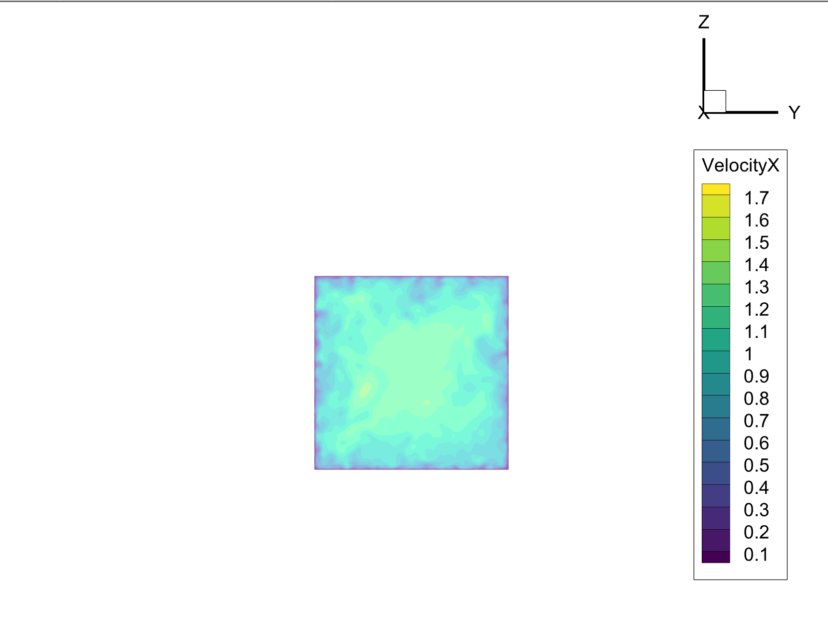

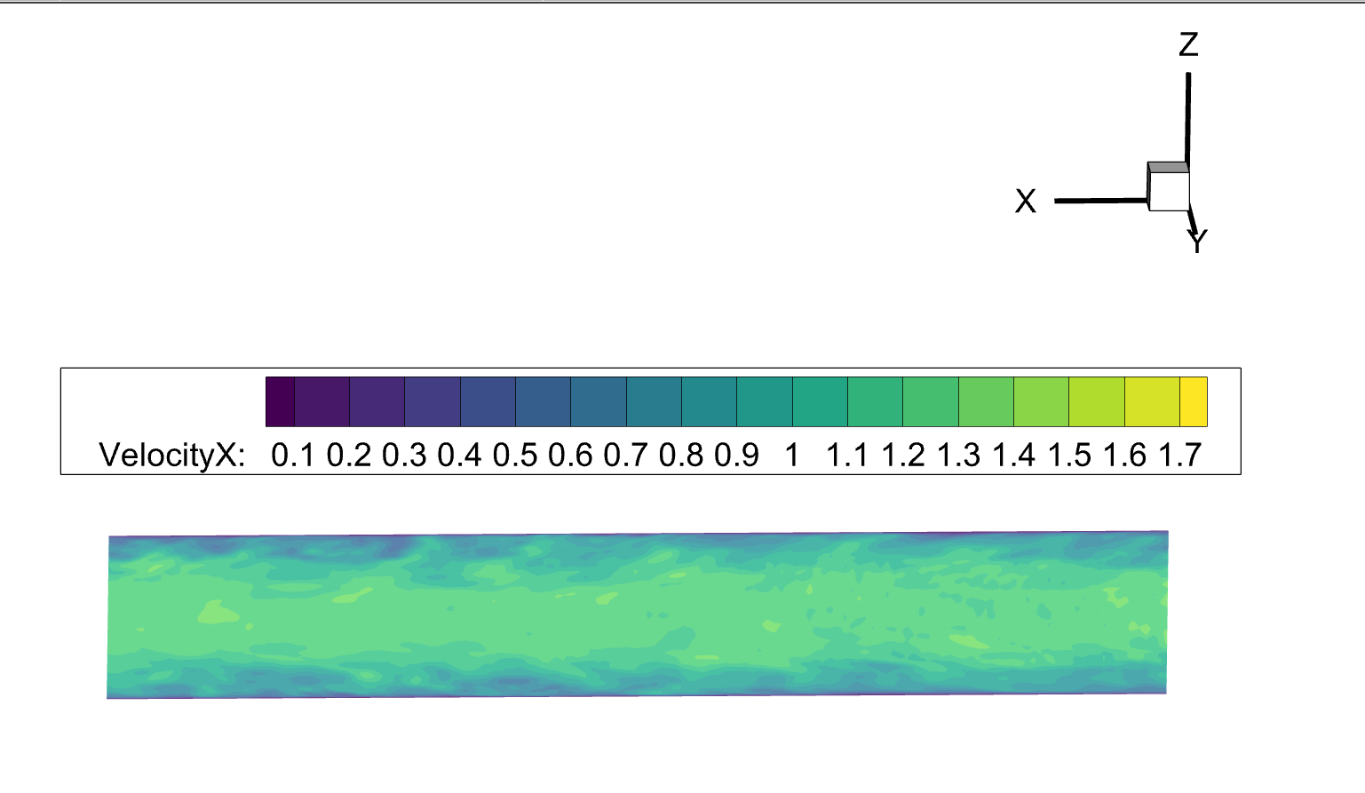

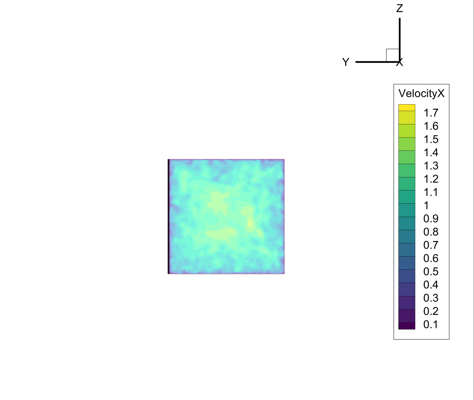

There are ductline ,outlet,inlet velocity profile after implementing the mapped inlet boundary conditions. Additionally, I would Not using the mapped inlet implies the need to set the inlet and outlet as periodic boundaries in the GUI, and subsequently use source terms to counterbalance shear forces?

Despite your previous advice, I have not been able to resolve the issue at hand. I have explored two different approaches.
Firstly, I attempted to use the "mapped inlet" method to specify the inlet velocity without employing any source terms. I ran the simulation using the RANS method for a significant duration, but the velocity profiles did not align as expected.
In my second attempt, I set the inlet and outlet boundaries as periodic and introduced momentum source terms to drive the flow. Once again, I conducted the simulation using the RANS method for an extended period, but the inlet and outlet velocity profiles still did not converge as anticipated.
I find myself perplexed by these outcomes and am unsure where the issue might lie. Here are the setup files for the periodic boundary and screenshots for the mapped inlet.
Thank you once again for your ongoing support and patience.
