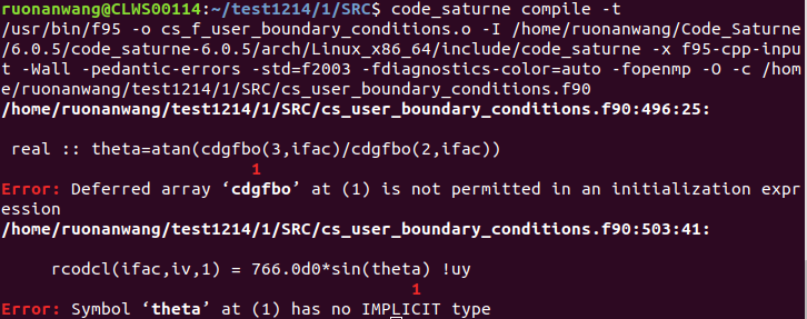

Thank you very much for your help. Yes I am learning Fortran online with some tutorials recently.
I revised my codes following your suggestions, it improved a lot, but there are still two errors which I didn't manage to solve it. Could you please have a look at it?

Re: Specify a rotation velocity on boundary
According the the error message, you cannot initialize the theta value at declaration time.
You need to simply declare it outside the loop, and assign the value as you have done inside the loop on faces.
Thank you very much for your reply and help. Finally I succeed in specifying a rotation velocity on boundary face. I would like to post my codes here.
