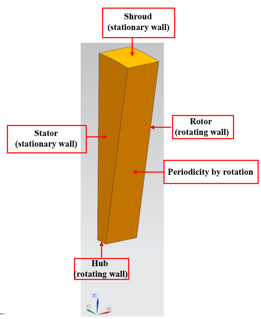

I am simulating rotating flows in an enclosed rotor-stator cavity. The boundary conditions are shown below.
I want to specify a rotation velocity (for example 100 rad/s) on the two boundaries: rotor and hub. Can I do this in the latest version of Saturne GUI, or I need to define it in the user subroutine /SRC/REFERENCE/cs_user_boundary_conditions.f90?
In Code_Saturne 6.0.5, I found when I choose "Sliding wall" in "Boundary conditions", the U, V, W are all in Cartesian frame.
As for the setting in user subroutines, because I am not familiar with it, is there any tutorials or examples I can follow please?
Ruonan

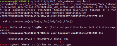

But when I trying to compile it in SRC folder, many errors appeared.
I think there must be many mistakes in the codes, so any help will be much appreciated. I am new to Code_Saturne and Fortran, trying to make progress. :)
Ruonan
Posts: 4290
Re: Specify a rotation velocity on boundary
To compute theta, you need to define z and y first. And base them on each face's coordinates. So using :
theta = atan(cdgfbo(3,ifac) / cdgfbo(2,ifac))
inside the loop is better.
Also, if you have compilation errors you cannot solve, you can post them here. But in most cases, reading the error messages carefully should provide hints to what you need to do. If you are not familiar at all with Fortran or C programming, you can find many tutorials or courses on the web. I could suggest a few.

I revised my codes following your suggestions, it improved a lot, but there are still two errors which I didn't manage to solve it. Could you please have a look at it?
The subroutine file are attached below.
Thank you very much in advance!
Ruonan
(21.25 KiB) Downloaded 342 times
Posts: 4290
According the the error message, you cannot initialize the theta value at declaration time.
You need to simply declare it outside the loop, and assign the value as you have done inside the loop on faces.
