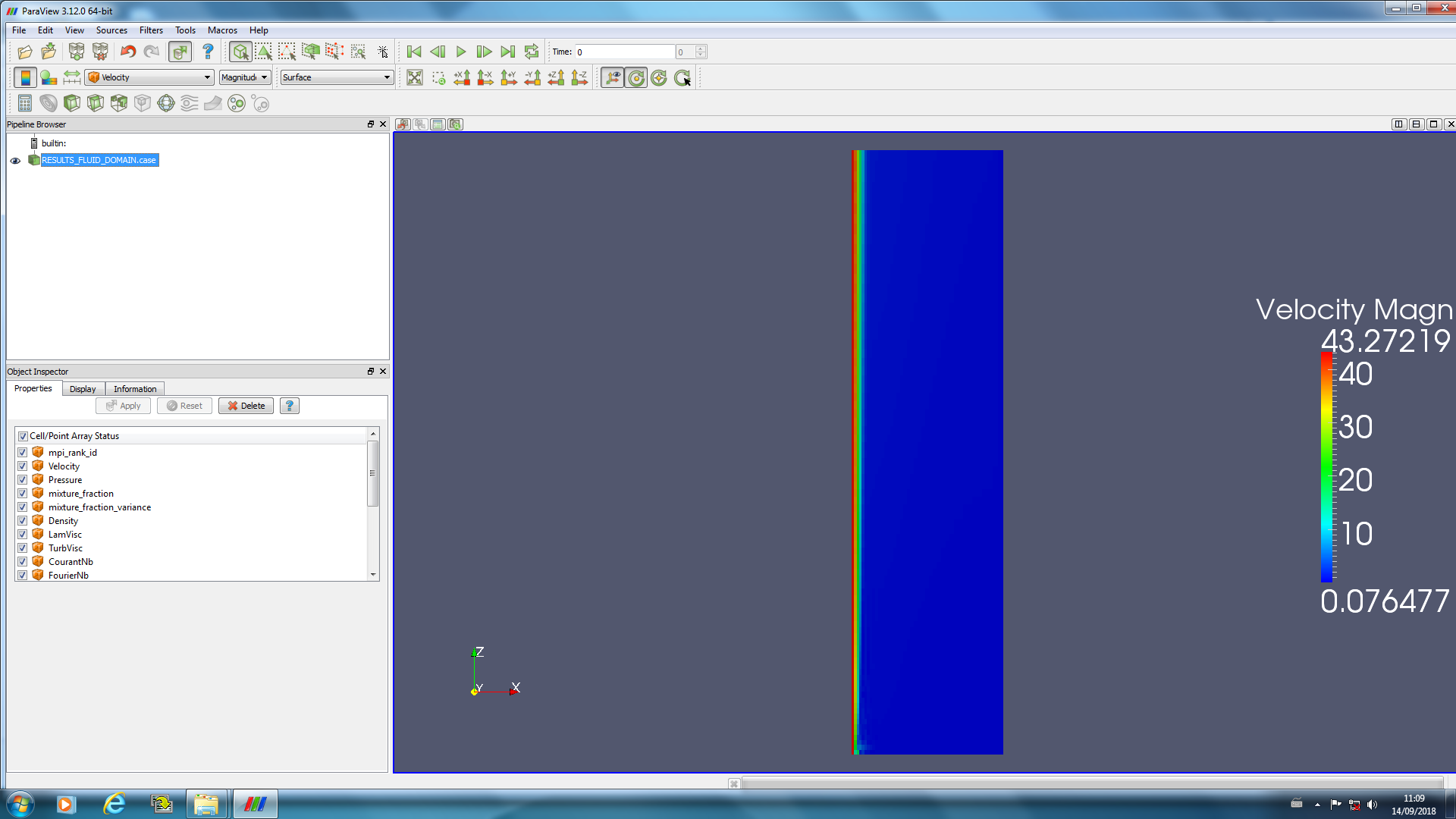

i succeeded to simulate turbulent combustion using large eddy simulation.
the model of combustion is the one proposed by code saturne 5.0.8.
But I have some problems:
- the velocity diffuse too much;
- when I activate species transport in GUI, an error appears.
