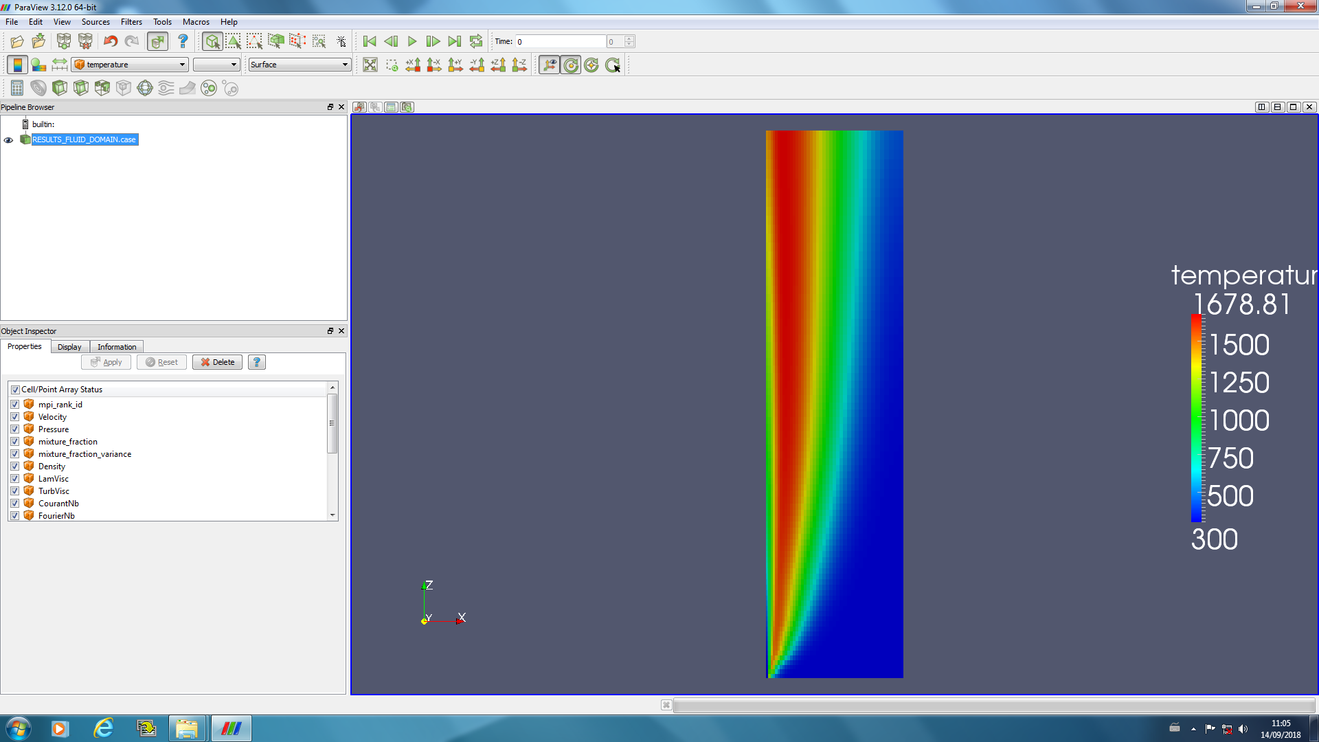

i succeeded to simulate turbulent combustion using large eddy simulation.
the model of combustion is the one proposed by code saturne 5.0.8.
But I have some problems:
- the velocity diffuse too much;
- when I activate species transport in GUI, an error appears.
../../../../src/code_saturne-5.0.7/src/base/cs_field.c:1075: Fatal error.
Fortran pointer of rank 2 requested for values of field "molecular_viscosity",
which have rank 1.
I don't have that problem when i use RANS
how can solve that issue?
Posts: 4303
Re: large eddy simulation and combustion
There might be a bug in your code (at least for the second issue). Could you post your code modifications ?
