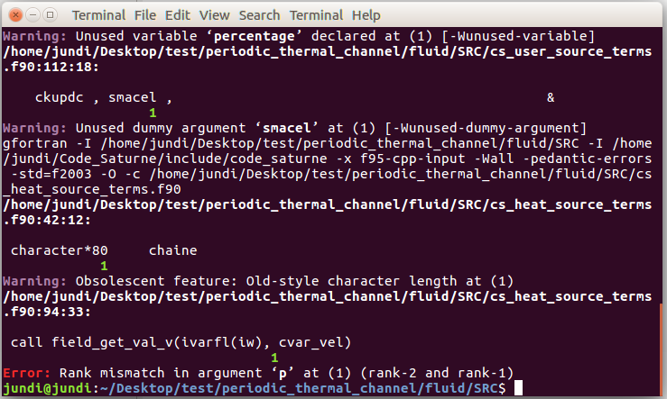

I am using a subroutine to impose the thermal source term for each cell in a channel flow. In the subroutine, I need to use the cell density and velocity (z direction component) to calculate the heat source term. When I try to compile the subroutine, there is an error comes from the cs_field API, the screen shot of the error is shown, and my heat source term subroutine is attached. Did anyone know what the problem is, thanks!

Yes, cvar_vel is a 2-dimensional array (dim*cells), so you shoumd not declare it with the other scalar arrays on line 49, but as:
on a nearby line (note the double instead of single colons).
[double precision, dimension(:,:), pointer :: cvar_velRegards,
