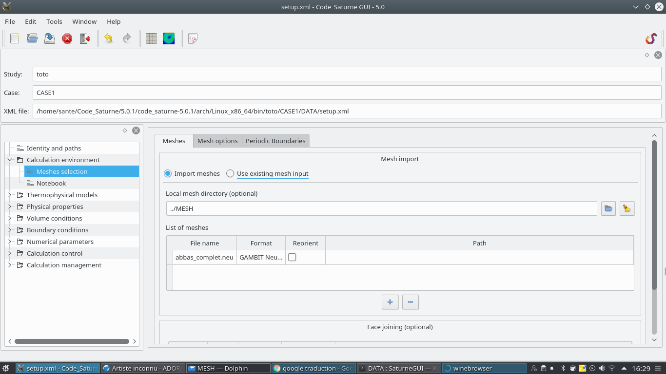

Since I installed the new version of code_saturne(C_S-5.0). I can not verify my mesh in the GUI.
"Please i need help"

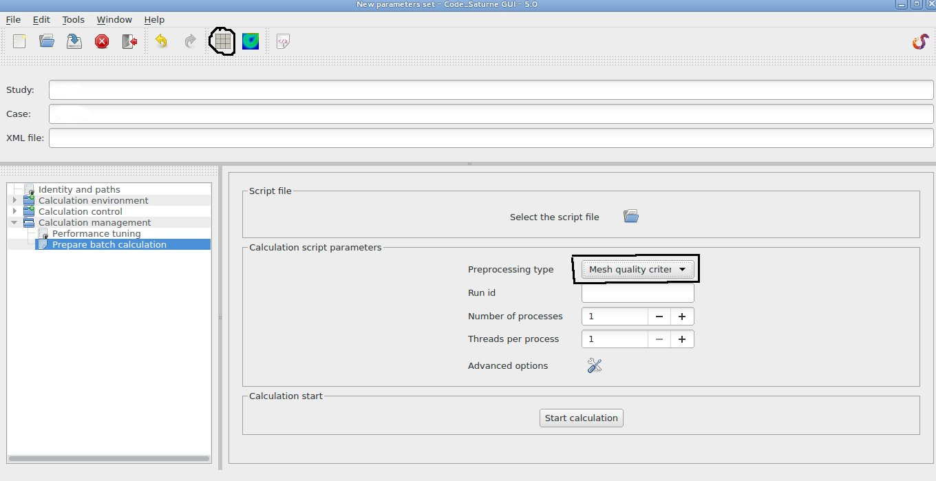

In CS 5 you have to switch to the "prepocessing mode" (in the fig that you post you are in the "calculation mode") and then select "mesh quality criteria" in the preprocessing type.

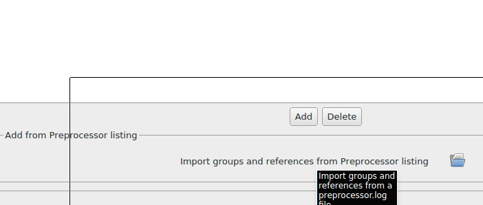

Thank you for your reply. Now I face another problem; When I want to load the boundary conditions I am asked for the file "check_mesh.log" which is absent. I do not know how to solve this new problem. Especially that I want to run a tutorial on burning pulverized coal with a Lagrangian approach.

The file that you have to read in order to load the BC's is the preprocessor.log as the pop-up notifications says.
