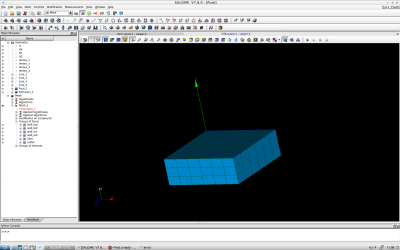

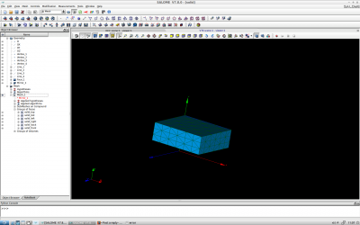

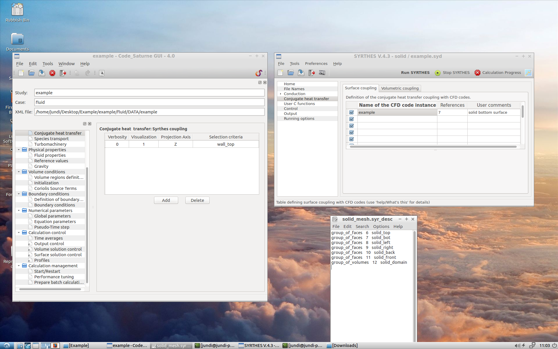

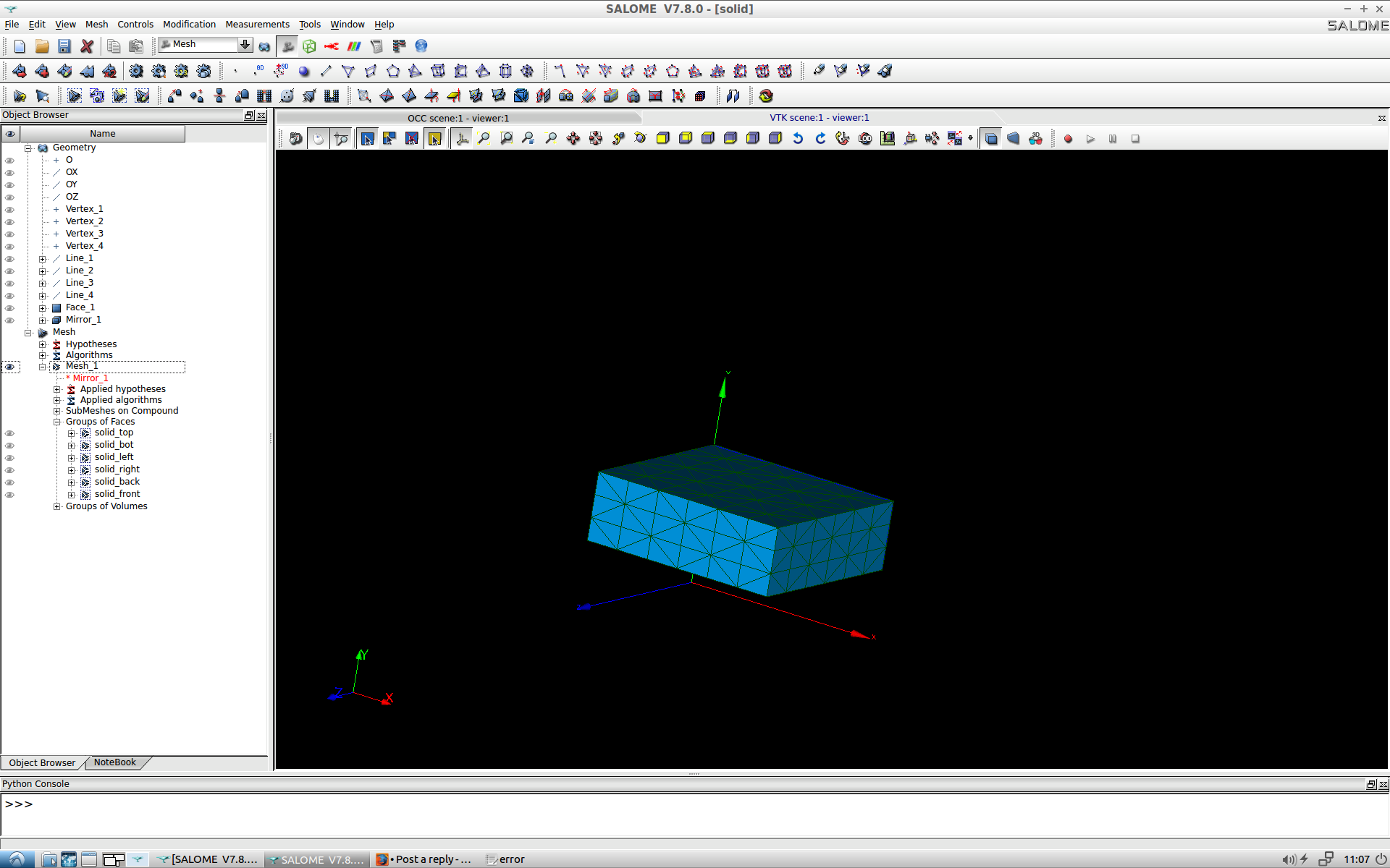

My geometry is a simple one, the fluid domain is in the below with the solid domain above. They share a face which is the top face of the fluid and the bottom face of the solid. The attached files are the solid and fluid geometries and the settings of conjugate heat transfer in code saturne and syrthes.

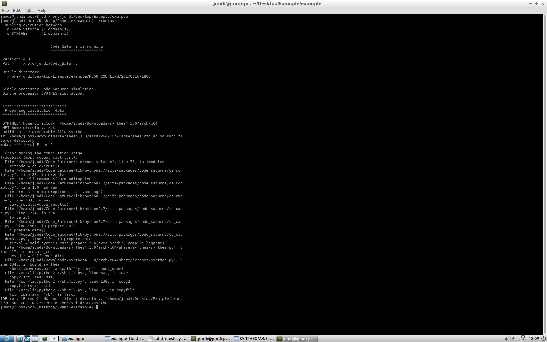

Hi I think I've run the coupling case in the wrong way by directly click on "run case" on code saturne. Today after I set up the fluid and solid domain and independently run them on CS and Syrthes, I save both case, and execute the "runcase" file. There seems to be some other Errors, this is the screenshot. Thanks.

The Error says that I am lack of a file syrthes4.3.0/arch/x64/lib/libsyrthes_cfd.a, when I click into this directory, I only see a file named libsyrthes_seq, is there some relations between these two files? Thank you again for the help.
Posts: 4299
Re: About CS coupling with Syrthes
This is probably an installation issue. At the end of your setup.ini for Syrthes installation, you need both to indicate a path to the PLE library (part of Code_Saturne, which can also be installed alone), and to indicate you want to build the CFD coupling part. Both are near the end of that file, so you should check that.
