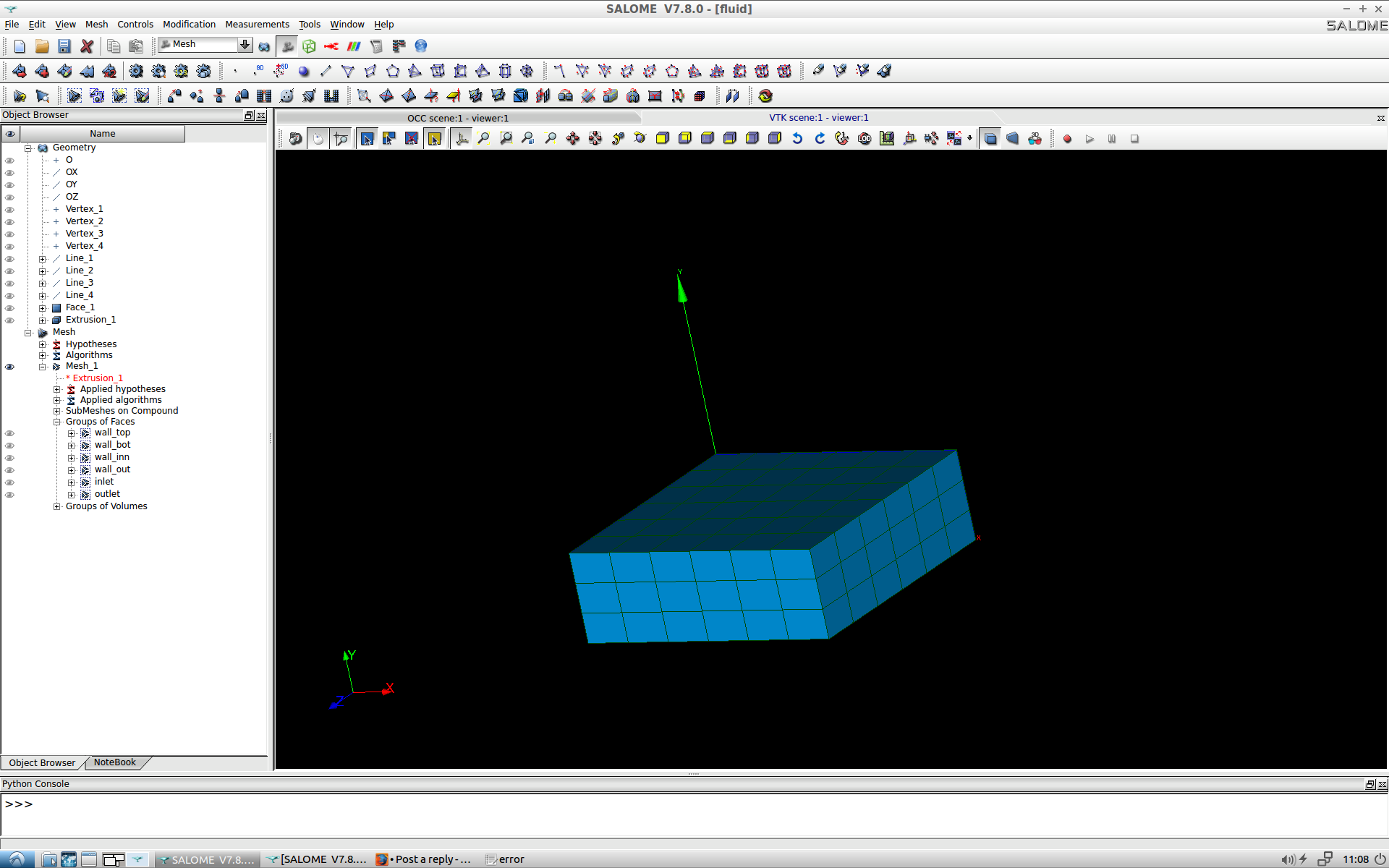

Now I have a simulation which has a fluid domain and solid domain. The fluid and solid geometries and mesh are built and generated by Salome. In the coupling of CS and Syrthes, I firstly independently run the fluid and solid simulation, and then click the conjugate heat transfer in CS and Syrthes, and couple the surface of the fluid and solid domain. After that I run the simulation in Code Saturne, and it came out with an Error, can't continue with the computation. The error file in the result folder says:

My geometry is a simple one, the fluid domain is in the below with the solid domain above. They share a face which is the top face of the fluid and the bottom face of the solid. The attached files are the solid and fluid geometries and the settings of conjugate heat transfer in code saturne and syrthes.
