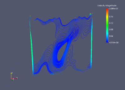

Hi,
Anyway, I got this
when I view the velocity in ParaView. Is this acceptable ?
Thanks
Luciano Garelli
Posts: 284
Re: Heated square cavity flow Tutorial 3 in Code Saturne 4.0
Post by Luciano Garelli »
Are you following the tutorial? The expected results are shown at the end of the pdf.
Could you post the listing file.
Luciano
