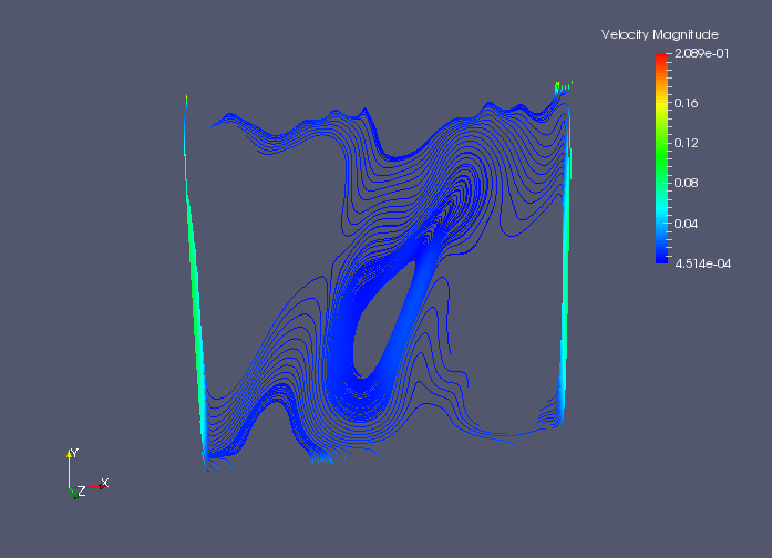

kennethchaw
- Posts: 36
- Joined: Sat Oct 01, 2016 6:31 pm
Re: Heated square cavity flow Tutorial 3 in Code Saturne 4.0
Hi,
Anyway, I got this when I view the velocity in ParaView. Is this acceptable ?
Thanks
Thanks
Luciano Garelli
- Posts: 284
Are you following the tutorial? The expected results are shown at the end of the pdf.
Could you post the listing file.
Luciano
