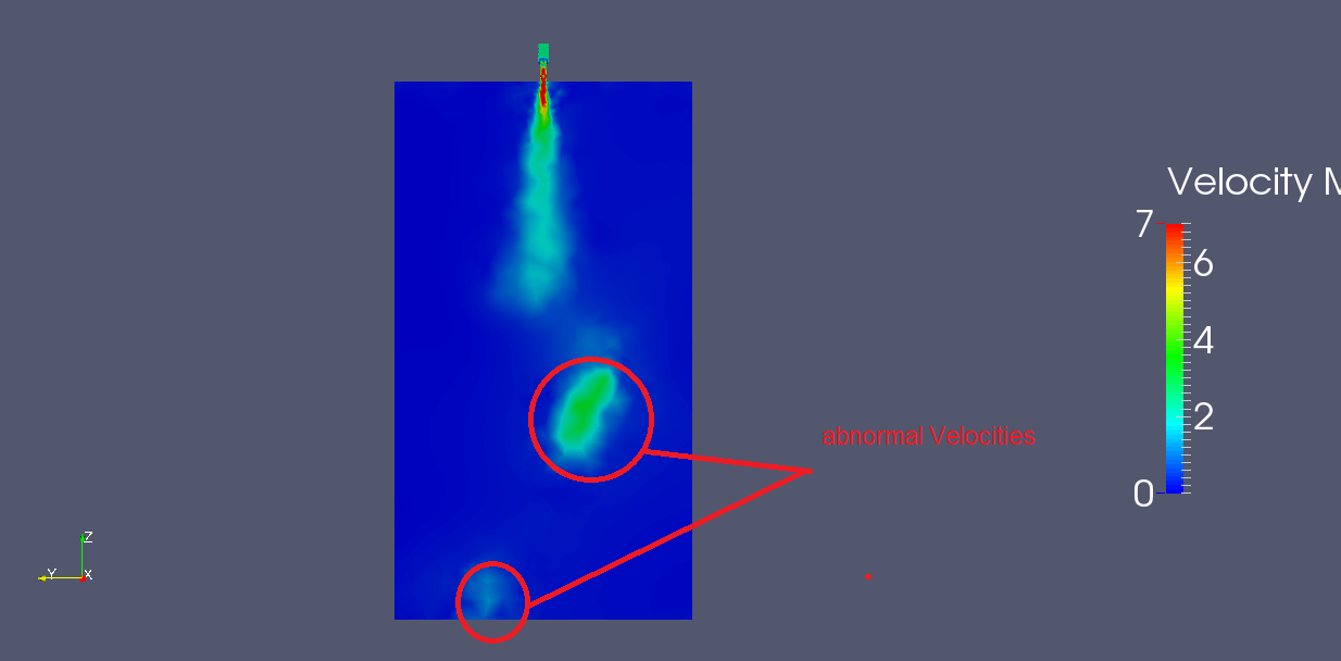

During a simulation of a air diffuser in a room, I have stranges velocities.
I have already change mesh parameters and time step parameters, but I would like to know how can I check what is wrong ?
In the listing file the Courant Number is correct and residual part too.
About the Fourier Number or the rate (Nb Courant / Nb Fourier) what is the correct value for that ?

Could you visualize the mesh quality criteria, and see if the strange spot correlates with that ?
If you have a mesh quality issue, for a simple geometry, using a "ijk" type mesh in SALOME would help. If that is not possible, adding more sweeps in the Code_Saturne resolution might help. Also, is you mesh 2D extruded, or fully 3D ? If you are using symmetry on some faces, extruding a 2D mesh will probably give better results than meshing a thin slice in 3D (if you mesh is not "thin", forget about this remark).
Also, are you using iterative or least-squares gradients ? With tetrahedra, least squares with extended neighborhood might be better.

about the mesh quality, there are 11 poor meshs on 495 000 cells so the meshing is correct.
Details about the mesh is in the attached file.
I'm using for the gradient calculation method : "Iterative handling of non-orthogonalities", so I will try with the least square method over partial extended cell neighborhood"

Did you try to reduce the Courant Number to get a Co~1..5?.
Looking at the figure that you posted, I think that you can do a structured mesh using 3D extrusion, doing a mesh for the diffuser, a mesh for the room and then gluing at the interface.

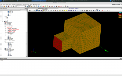

This is a good remark, I have changed the meshing netgen 3D-2D-1D for the diffuser and hexahedric (hexahedron i,j,k) mesh for the room and assembled it together, I think this is the best way, but the junction is bad and my simulation diverge (conjugate gradient).
I would like to know, if there is a step in Salome to improve the connection between the two meshs ?

I tried to do the meshs junction properly with a simple case between 2 cubes.
Firstly, I tried with hexa meshs, and it's work correctly, when I make the junction in C_S or in Salome (build compound).
Now, I'm trying to make the same thing but with complex meshs (NETGEN).
I have successfully made the meshing junction (conformal mesh) thanks to the function projection 1D2D with a sub mesh.

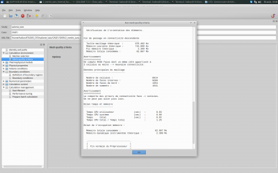

After that, when I am "checking the mesh" in C_S, I have the following mistake "bad connectivity for the cells" (see attached file in French), with a mesh junction in Salome.
I also tried with two meshs with the junction in C_S, but I have also a mistake, with the error in the listing file (attached) : "420 faces have a null distance between centers, For these faces, the weight is set to 0.5"
Thank you for your help.
